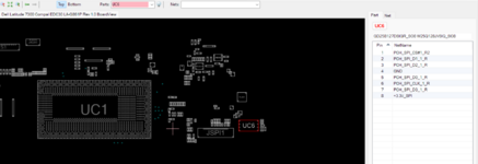

GD25B127DSIGR_SO8 W25Q128JVSIQ_SO8For example the bios i saved from my dell latitude 7300 is 16m and all the ones i found where 33m

Ok so the bios chip is 16mbGD25B127DSIGR_SO8 W25Q128JVSIQ_SO8
16mb
Main Bios Chip Detais and location.

The UC6 is not thereGD25B127DSIGR_SO8 W25Q128JVSIQ_SO8
16mb
